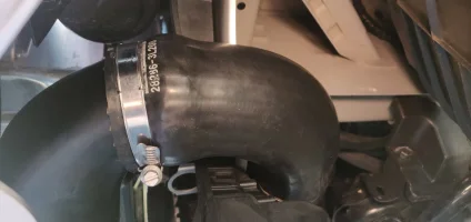

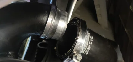

Yup, did some datalogging. IATs were over 10° lower when I glanced down at my phone. I'll post a review later. In the meantime, the inlet hose popped off after several power runs, because the G70 inlet hose is not the same type as the Stinger inlet hose.
This is how I'm improvising at the moment... Lol..
We will see how long it lasts. Anybody have an OEM Stinger inlet hose you want to sell me? Haha.
