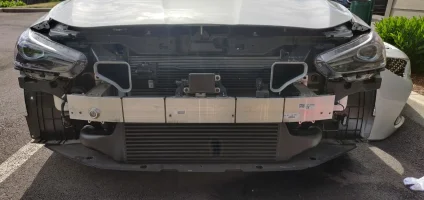

For those of you that don't know how to install this thing, Tork made a simple how-to video showing the whole process. It's easy, VERY easy. My car is a G70, so a couple things were slightly different - i didn't have to trim my radiator shroud (though I have VT snorkels which remove the shroud anyway, but the G70's shroud isn't nearly as intrusive as the Stinger's shroud). Also, the inlet coupling on the G70 is different than the Stinger - mine doesn't have the spring clamp, instead it uses a regular screw style clamp.
Tork Installation video, for reference...
And here it is installed on my car....

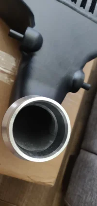

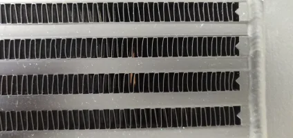

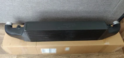

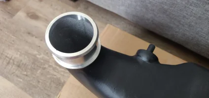

Now, onto the comparison and testing... First off, upon receiving the intercooler I took some up close pictures of the interior and exterior core, along with the inlet and outlet....
And this is an interior shot of the core, using my borescope....

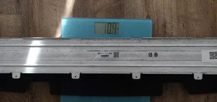

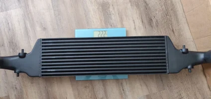

The intercooler weighs 22.2lbs, according to the scale I had access to.
The OEM intercooler weighs 10.4lbs on my scale, and has plastic end tanks with a sharp 90º angle where the tank transitions to the inlet/outlet.

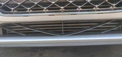

I installed my AP Intercooler yesterday on my Australian GT but it seems to be a very tight fit. Looks like the Australian Stinger has 2 additional vertical members (see attached) do you think it could rub through the Intercooler over time?

Huh... That's interesting. USDM Stingers and G70's definitely do not have those metal brackets welded to the crash bar.
I honestly don't know if it would wear through, but, I suppose it's possible over a long period of time. The intercooler is aluminum, and those plates/brackets are probably steel. Personally, I'd either squeeze some 1/8" (~5mm) rubber sheets in-between the brackets and the intercooler. Or, just cut off the brackets (that's actually what I'd do). Would save a couple lbs. Haha.
Good luck, and let us know what you end up doing!
