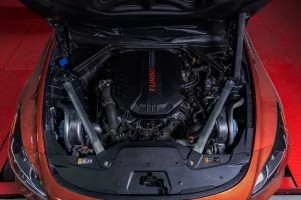

The Agency Power intake is now in stock and ready to ship
Full roto-molded plastic intake shield and pipe, this intake wont heatsoak like your typical aluminum intake system
Will update with DYNO sheets once available
PURCHASE LINK
Agency Power Dual Performance Intake - Kia Stinger 3.3TT
PURCHASE LINK
48382455_10157615090392784_6917332966678986752_o.webp 48389046_10157615090262784_2191429147782283264_o.webp 48370368_10157615090667784_945076676964909056_o.webp 48391473_10157615089837784_9131778298739687424_o.webp 48424374_10157615090027784_6806069562543439872_o.webp

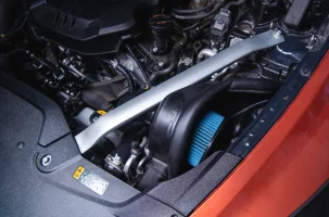

This Install Guide is intended to help with the installation of the Agency Power Cold Air Intake System on the 2018 – 2019 Kia Stinger GT with 3.3L TT V6.
Unbolt 2 bolts holding cross support bar on driver then repeat on passenger side. Remove bars and place to the side to re-install later.
Removal of Factory Air Box Same For Both Passenger and Driver Side. Loosen clamp on intake tube. Find the 3 bolts, 1 at the top of the air box near shock tower and 2 along the fender sides. Unbolt the 3 bolts and carefully remove air boxes. Keep the 2 fender bolts they will be re-used when installing new air boxes.
Removal of Driver Side Factory Intake Tube. Loosen clamp at end of intake tube holding tube onto turbo.
Loosen clamp on hose near top of tube towards air box and slide off hose.
With clamp loose and hose removed gently loose intake tube to allow better access to the re-circulation hose. Use pliers to open clamp to allow for hose to be taken off intake tube. Then finish removing intake tube.
Removal Passenger Side Intake Tube. Loosen clamp at end of tube that is attached to turbo. With pliers squeeze open clamp to allow to pull off re-circulation tube. The remove intake tube.
Installing Driver Side Intake Tube. Using the intake tube with 2 fittings and inlet. Install coupler onto intake tube then onto the turbo. Tighten but leave loose until air box is secured into place.
Install re-circulation hose and use pliers to place clamp into position.
Place lower hose onto fitting and clamp.
Place upper hose onto fitting and re-clamp.
Air Box Installation. Remove 2 rubber grommets from factory air box. Push metal center out then grommet should be flexible enough to remove. Install into new air box.
Remove clamp from filter and slide filter into air box. Then place clamp back on filter.
Find the 2 bolt holes in fender that were removed during removal. Place air box holes over top. Sliding the air box rectangle cut outs into the factory scoops.
Once air box is set in place. Put air filter onto intake tube and tighten clamp.
Then re-install the 2 bolts into air box fender side. Then tighten all clamps.
Installing Passenger Side Intake Tube. Install coupler onto intake tube then onto the turbo. Tighten but leave loose until air box is secured into place.
Re-Install the cross support bar using the factory bolts repeat on passenger side.
Congratulations you have installed the Agency Power Cold Air Intake on the Kia Stinger GT
PURCHASE LINK
PURCHASE LINK
View attachment 16869 View attachment 16870 View attachment 16868 View attachment 16871 View attachment 16872
