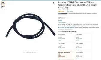

Factory vacuum Tee fitting is 5mm diameter, so you need 5mm ID (inner diameter) hose to fit it properly. OD (outer diameter) doesn't matter at all, but will affect which clamps you can (re)use.
I just ordered some of this: https://a.co/d/7gsrmw3 which has an ID of 5mm and an OD of 11mm:

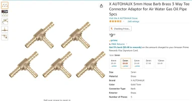

Which arrived today, along with some of these...
Which seem to fit together well, but I'm definitely going to need some hose clamps because silicone is slippery stuff inside and out. The nipples on these brass tees grip well, but just a little twist in either direction followed by a little wiggle and they start to slide out.
Now that I'm not in "crisis mode" I, too, want to look around a little. I'm going to keep the brass T-fitting because it's *way* nicer than the brittle OEM plastic one, but the freedom to find other hoses is just too good to not pass up.
