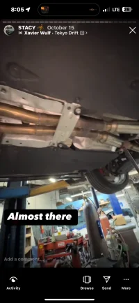

Ofcourse man NP, If you want a deeper sound and reduce rasp drastically then give the H pipe a shot. Very cheap. I paid $250 for them to make the pipe and also install. He also fixed some leaks in the exhaust behind the muffler too.

Ok so I did the cat back before installing MBRP resonators. Had insane drone so I decided to get the resonators to replace stock ones. In terms of drone I’d say it reduced it by like 20-30% but it was still there but it also made the exhaust more quite at high rpms - then I installed tips that extended past the diffuser and THAT completely reduced the drone by a LOT. I did the H pipe to help with the annoying high pitch and the insane rasp from the hfc downpipe. Which it helped quite a bit. Rasp reduction felt nearly 80%.
