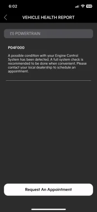

I recently bought an aFe open CAI for my ‘23 2.5T GT-Line. After a couple days of driving, the check engine light came on. I contacted aFe and after about a month they sent me a new tube with a metal insert that sits inside one of the vacuum ports. After installing the new part and a couple days of light driving, the CEL returned. I tried clearing the CEL with a code reader, but the CEL always comes back. This is my daily driver, and I am concerned about my powertrain warranty.

P04F000 is the code. I should have included that in my original post.
Remove the intake clear the code and test drive
Did that over the weekend. So far, so good after replacing the factory intake. I’m 99.9% sure it is an aFe design or manufacturing issue.

The code is P04F000
That's a fuel evap control system code. Shouldn't have anything to do with your intakes. It's possible you might have knocked something loose while installing the intakes.
I would also try disconnecting the battery let it sit for a good 30 mins and have the key away from car a good distance so the ecu resets and relearns. I did that when i got the k&n intakes installed.
But yeah most likely you knocked something loose while installing. Hopefully all is good once you reinstall it. Those vacuum lines definitely double check them once installed.
