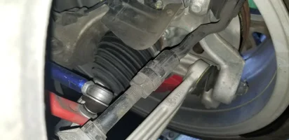

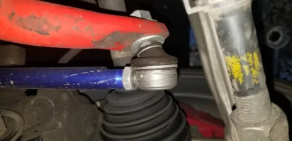

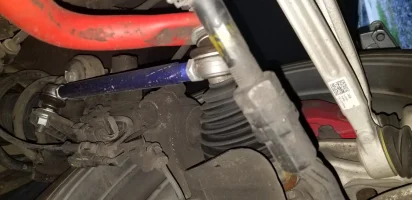

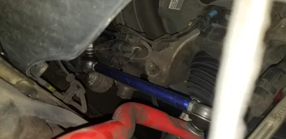

So i got my Endlinks installed by my dealer a few weeks back. Lately my suspension has been sounding kind of rough especially on shitty roads. Had my car up on the jack today as I needed to grease my sway bar bushing. Took a couple of pictures. One with car raised and other with wheel on ground. I just don't think the lower portion of the Endlink was installed correctly. Take a look and let me know.

Does it make clunk sound when you hit bumps ? mine hits the control arm when hits bump going to adjust them tomorrow see if that fixes it .
Weird, I'm having the same exact issues with my SuperPro front end links. The rears don't make any noise, but the front one has a nut (lower nut) that rattles.
I took a video to show that the lower nut can be hand tightened after a short drive and sent to SuperPro to see what they think.
Contemplating going back to stock end links since I don't plan on lowering the car at all.
Had shop adjust them no more noise at all they just shortened end links about 1/4" and no longer hits control arms.
Hmm, wonder if that's my issue since the shop adjusted my Superpros to the same length as OEM.
That's what shop did with mine first time , said the shortened it about 1/4" not heard anything since that was Saturday.
