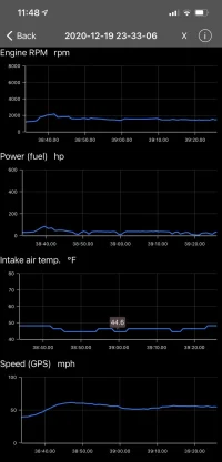

@Travis Wills This will be the track/race gas setup. I anticipate IAT's near zero (hopefully) by the end of the run. I believe it would be no different than running the car up North where temps are below 32 deg. The car will adapt fuel no issues. HPFP generally have crashes if you're running too much E-85, with high Octane and meth as a supplement, I truly believe that car is going to love it. I've watched just about every video on super cooling the inter-cooler available on YouTube and the results are indisputable :) This should put her on the next level if I can get the launch sorted out again.
@Travis Wills Something else I'm working on is timing. You can't spray or water down your inter-cooler anywhere near the stage or up to the 60". Super hazard and dangerous, not to mention you'll get booted off the track in a split second if you water anywhere near the launch area. I bought a few Arduinos that simulate the JB architecture, and programed a delayed solenoid launch that is user adjustable. I hit Terry up about the concept and is willing to incorporate it into the JB. I showed him my circuit and he approved and is ready as soon as I am to send me an experimental Firmware update. After I test it, it's game on and the JB will then control a Nirous solenoid. It will be good for an inter-cooler cooler, OR, regular Nitrous once someone dares and install it and get that sorted out. :p
