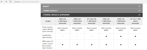

I think variable steering ratio is what causes that feel in the centre. Just a thought. Happy to be corrected. May be I am not used to it.Kia Stinger GT Steering Specs.webp
