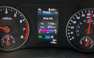

37.0 mpg for 2.5T AWD on Highway Trip.

I'd like to see a LONG roadtrip that consumes a full tank of gas, returning over the same roadway (to account for any elevation and wind change/loss in either direction), at the same speeds. 37MPG isn't realistic for the 2.5L , the 31.5 MPG result is closer to reality. None of the car computers do a good job estimating on only 3-4 gallons of fuel. They need a healthy sample size to be at least ballpark close.

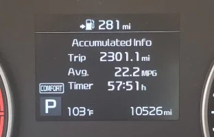

I've left my trip2 meter untouched for a long time, so that's been my gauge for overall fuel consumption rate if I don't intentionally get out paper/pen and calculate it later. The 22.2 is mixed city/highway, not a lot of highway since no recent trips in those 2300 miles. I believe the 23.2 is lifetime, being higher because I had some longer highway trips early into ownership of the car.

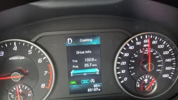

Just did another Chicago area to Milwaukee area trip. This time with the Air Conditioning on. Didn't use cruise at all, and used either Smart or Eco mode. 102 miles, averaged 35.7 mpg with AC on. Mostly between 70 and 80 mph, often following other vehicles no closer than a "1 Mississippi, 2 Mississippi" distance. Picture from when I started slowing for my exit...
I typically like to drive around 85 mph on these trips and maneuver around slower traffic, but that drops the fuel economy quite a bit.
