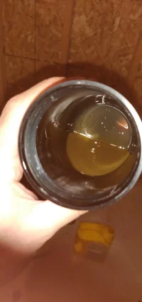

SXTHElement uses the exact same catch can design as Mishi, it's just the setup that's different. It's very effective. I had plenty of oil in there just after 1400 miles. Take a look...

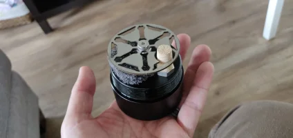

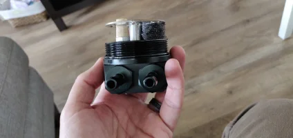

And a look at the filter and diffuser design...
