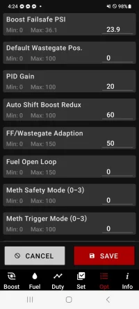

How do I adjust the PID gain and auto shift redux? Is this in the user adjustment for map 6? when I open that all the values are blank, will they go to a default setting with the firmware update?

OK, so I've updated the jb4 to the latest firmware and changed the settings in the user adjustment as per AWDGT2's post.
Ign 2-6 have been dropping the last few days but looks to be making small corrections to #4 at times. Will likely try map 2 in the next couple of days but pretty happy with how map 1 performs
LOL, it's doing exactly what I predicted. Cy #4 at 1.5 for a split second is noting, it's .8 the rest. So they already went from 2.3, to 1.5, to .8. Another day or so you you should see all 0's unless your shy on octane. Your log looks really clean and I would say go for Map2
