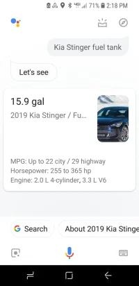

Follow up to my earlier post on the pure gas fill. Got 382 miles out of that tank, 13 miles to empty and put in 15.7 gallons of 10% blended Costco gas. Works out to 24.3 mpg. Most I've ever put in the tank was 16.2 gallons with about 9 miles to empty.
Ahhh, that's a good question. I've found that with KIA hybrids you can get more than the rated amount in, 2012-15 was rated at 17.5 gallons (if I remember correctly), but you could put 22 in it, got 840 miles to a tank. In my 2017, it's rated at 15.9 and I've put in 20 and got over 900 miles out of it. Figured I'd give it a try on the Stinger and that's how I got to 16.2, up to the neck, no spill over.
