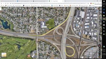

A certain cloverleaf is my "skid pad". :p
