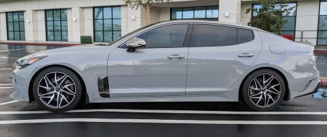

So I put springs on my car took it to the dealer to get it aligned they had if for an hour and a half came back and told me no charge they couldn't align it their machine software isn't updated to 22 model to come back in a month. I don't want to wait that long to get my alignment done aren't all the Stinger chassis the same ? I'm driving a 22 GT line Thank you

I installed lowering springs
It's literally the same for every year of Stinger. Definitely find a different shop, because those guys sound pretty braindead to me.
Just got mines done at Mavis. Definitely need it after lowering the car. Big difference with handling and comfort
When I installed my springs, the dealer couldn’t get the car on their alignment rack because it’s too low. The things we do for fitment
So got a speed shop to do it to three whells are ok right front ha a 1.4 camber wonder how much that will affect tire wear?
it won't affect it that much. Toe is what you need to be most worried about.
