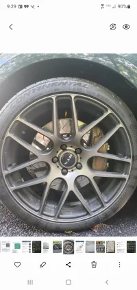

I’ve done the Brembo swap in my 2022…well, fronts anyways, so far. Unless you can get the seals/dust covers easily, I’d suggest keeping them red- it would’ve solved a few problems and saved money if I had not had mine powdercoated- personally, didn’t like the red on green. Didn’t spare any dough, but I did shop around to find best pricing, the results are really good and worth it. If you have an early 4-banger turbo (2018/2019 I think), you have even smaller rotors and will see even bigger improvements. I admit tho, the stock brakes on the 2022 were already pretty good, they just got better….

I get it, cosmetically it POPS! But even getting the calipers off EBay, it gets pricey- I could’ve mitigated the cost by going with the DBA rotors in the front, but the EBC rotors sure are a fine product and I have no regrets spending the extra 5 hundos on them.
