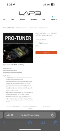

Hey! Just picked up my 2022 Stinger GT-Line! I was familiar with the JB4 on my Supra but I’m new to it on the stinger platform. I was hoping to see if anyone has a 2.5T Harness JB4 for sale for a reasonable price? Also what’s the hp bump for map 1? Is it worth it? Anyone have any problems with running it?
Also what are the thoughts on LAP3 tunes? Would this work for my stinger since it’s the same motor as the K5 GT? Do you get more power out of it and is it more safe?
I would appreciate the help! Thanks!
