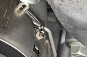

Does anybody know how to remove this small clip without damaging it. Incase aI want to return to stock. It's where the intake connects to the turbo housing Thank you

Yeah, that took me a bit to figure out. The clip holding the round wire spring down can be pried up a bit to let the wire spring escape. It's kind hard to explain in words. Best thing to try is to take a small hook tool to pull the clip up and around. You will feel which way it has "give", so you can work the wire spring out of it. I used my mini-pick set to do this. It's actually simpler than it looks.
I'm pretty sure that clip can be removed entirely and that might be the proper way to do it, but I found I didn't have to. Just don't bend it too much and leave a set in it premanently.

Ok Thanks that makes since,I have a small pic set that should work pretty good was the clip reusable afterwards if you're careful?

Mine kept its original shape and tension, so I would say it is very reusable, if I ever put the stock intake back in.
Again, the key is not to pull too hard. Like I said, I didn't have to, and the wire spring escaped fairly easily.

Okay thanks again. Doing 30,000 mile service tomorrow plan on installing afterwards

Ok installed the CAI pretty straightforward. Useed two small hooks to free the c-clip that worked well.
