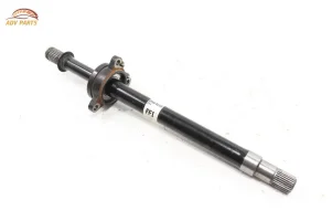

The problem is this part - 49560-J5000 - Bearing Bracket Sh(aft?)
As pictured above, the left side connects to the inner CV shaft. The bearing bracket itself is bolted to the oil pan. The rest of the shaft goes through the oil pan into the front diff. Given the white color of the grease, he suspects a seal failed within this bearing. Repair requires replacement of the whole shaft as it's one assembly.
Of course to get at it requires teardown of some suspension/brake parts. Parts on order, eta a week or less.
They were surprised to see this go on such a low mileage vehicle. My guess poor construction/assembly. Maybe the seal wasn't fulled seated.

Got to examine the old part. No visible leaking on the visible side. Must of blown its load on the hidden side (facing short end of the shaft). The old bearing wasn't crunchy or grinding, but did have less smooth feel than the new one.
