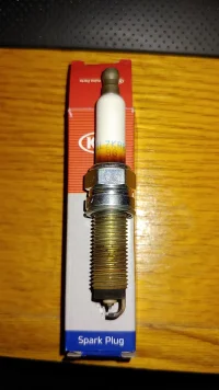

- OEM plugs are NGK IR SILZKZR8H 9G; Gapped between .034-.036 inch.
- I bought OEM plugs from the dealer because of reports of counterfeit plugs from online sellers. Part number 1885709085. Dealer OEM spark plugs came pre-gapped.
