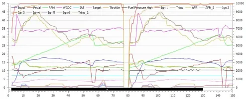

Hey guys had my JB4 for a while now got a decent amount of bolt ons at this point but I just wanted to know if my logs look okay? I’ve tried figuring out what I’m looking for/at but I still don’t think I’m catching on as fast as I’d like.
I did two quick logs idk if they are long enough ?
Running 92 octane+ Vp cat safe octanium
2250 being a 0-60 ish run
22115 short 40 roll
Updated: full launch is what I would assume is the best representation. Of the actual logs
Lots of bad rain where I live can make and post longer logs if needed

Not the best logs. Start in 3rd go WOT thru 4th, basically do a 30 to 90 pull. You should dial back to Map 2 do a run, if and only if it looks clean move to Map 3 and repeat. Do you have EWG wires?
Will do on my way home, probably post in hour or 2 . All wires connected, including the two fuel wires.
Any better ?
Also your message made me go and check my ewg wires and someone one of my wires came unspliced so I had to remove the wires and put back to just stock wires
Any better ?
Much better pull. Looks pretty good to me maybe someone else will chime in. What fuel was in there for this run. You get some timing pull in lines 84.50 and 85.25 not sure what thats about but it’s very brief. With your mods you’ll want to get those EWG’s sorted out pretty quick, then try a Map3 run.

And gas was the same as prev Chevron 92 + octainium
Log seems reasonable to me.

hey man got my wires installed. Did a map 3 pull was wondering if you could spare some more of your time. I feel like I saw 1 timing pull that happens twice in a row so I have turned it back to 2 for now but was hoping you could see if you saw the same thing. There are 2 30-90 pulls in the log! Thanks a ton.
The first pull is a bit dirty but it cleans up in the second and looks pretty decent. I would try another map 3 run.
Awesome will do it on my way into work tonight, again thanks for the help!
Here is the newest pull map 3!
I would say it looks pretty good. #6 is giving you a bit of timing pull at top boost but very brief. Maybe send that one to BMS and get Terry’s thoughts. Or hopefully one of the real sharp guys on here will chime in. Cheers
