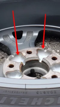

15mm spacers will not work with the stock studs and stock rims..
Would be an Interference fit with the studs hitting the back of the rim pockets.
20mm spacers work... And just barely clear

My winter 18 steelies DO NOT FIT with the spacers, as the steel wheels do not have provisions (cut outs/pockets) for the OEM studs to fit in, since they protrude through the spacers. (I could cut the length of the original studs, but I don't want to.
The OEM rims have nice deep pockets between the studs, so the 15mm spacers should work, if you want only a 15mm spacer.
And I verified the spare tire also has similar provisions.

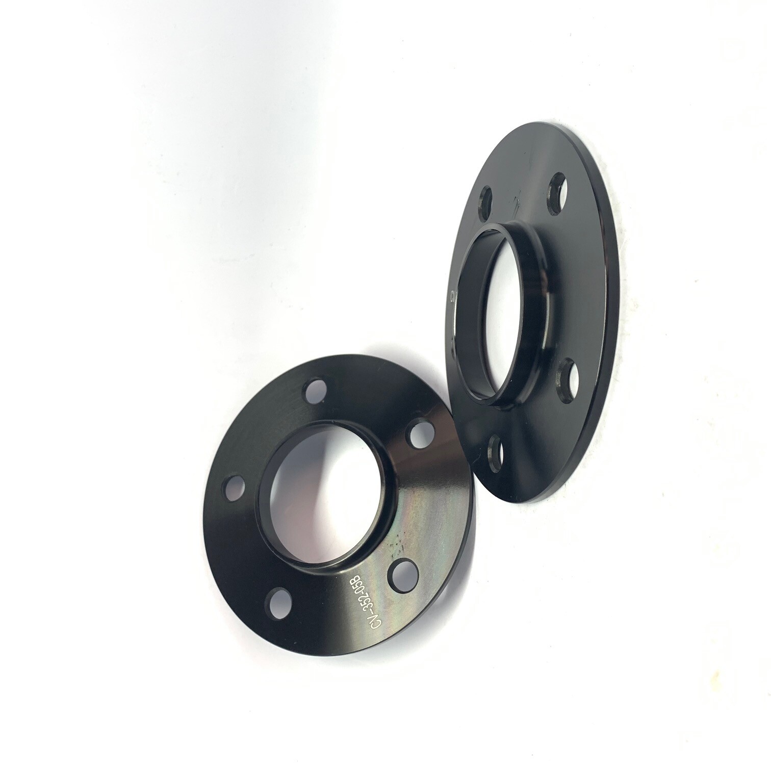

Since there was some earlier discussion in the thread about hubcentric 5mm spacer, I thought it's worth mentioning that there are true hubcentric 5mm spacers, but not for stock wheels. I bought these for my Enkei TFR wheels to bring the 38mm offset down to 33mm, which is as close to the stock 34mm front offset as I can get it. 2) 5mm Black Hubcentric Wheel Spacers | 5x114.3 5x4.5" | 67.1 Hub to 72.6 Wheel | eBay
FWIW, unless you are just doing it for looks, I wouldn't bother putting spacers on stock wheels. They already have the correct offset for optimum scrub radius. Deviating from that too far, especially at the front wheels, and the car could have handling issues, particularly at the limits.

Coming to this post a bit late. But I got some 18x8.5 +30 ESR RF2 wheels and I’m thinking of grabbing 5mm(?) spacers to throw on the bring them out just a little more for aesthetics. I see that link you originally posted is out of stock. Any ideas on other TRUE hubcentric spacers?

Well, that would all depend on your specific rims center bore
What is your center bore?

Looks like ESR RF2 in that size has a 73.1mm bore. This is actually the same as my latest Enkei RP01 18x8.5. I use these on the RP01's:
5mm Black Hubcentric Wheel Spacers | 5x114.3 5x4.5" | 67.1 Hub to 73.1 Wheel
You'd need to verify that, of course.
And if you need to search, Google "5mm hubcentric spacers 5x114.3 67.1 to 73.1", or whatever your wheel's bore diameter is.
The good news is, If you can find 5mm hub centric adapters for your exact usage case...
5mm hub centric spacers 5x114.3 67.1 hub to 72.6 rim
Then you would no longer need any centering rings. (Win win)

Yep, ESR's own website lists it as 72.6mm. I originally looked it up on Fitment Industries and they listed it as 73.1mm. That's yet another reason I don't like them too much.
I also just did a search and sure enough the ebay seller was the only one that has them. Didn't know they are that rare, since I had no problem buying both 72.6 and 73.1 from them. May be my posting their ebay listing online got them sold out... who knows. Maybe contact them to see when they will have the next batch?
