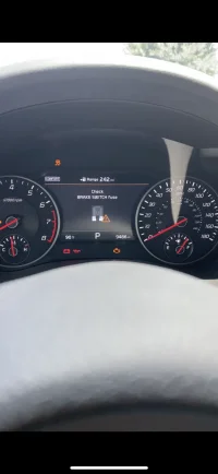

Unfortunately this is my first post regarding my GT2 as it is about a malfunction it is having. I bought it a few months ago from a dealer used with less than 7k miles on it. A few days after driving it I noticed my cigarette lighter in the front wasn’t working cause I connected my radar detector to it but it wouldn’t turn on. Looking in the socket I found a dime stuck all the way inside it. I was able to take it out with the car off (to avoid any more shorting) and I had to switch the fuse as it had blown out. After that the plug was working again. A month went by and one random afternoon getting out of the grocery store I tried to open my trunk and it would not open. After removing the door handle thing to get in manually I did notice it wasn’t the battery as the car was still lighting up and the speedometer dashboard was on. Then when I tried turning it on the warning in the picture attached came up. Looking online I found one Kia dealer’s website mentioning to replace the fuse or if not possible just hold the ignition button for 10 seconds to turn the engine on. Luckily that worked and I drove home like if nothing happened (I know not very smart). Now it’s happened again, a month later, but now the electronics aren’t working. The touch screen won’t turn on and even traction control is off. I’ve tried finding this “Brake Switch Fuse” everywhere and I can’t seem to find that label in any of the fuse boxes. Can anyone help please, I’d very much appreciate it. I’ve contacted the dealer near me but they can’t look at it for another week (busy from 4th of July).

Forgot to mention, I don’t even know if these two problems (cigarette lighter fuse and brake switch fuse) are associated with one another but it is an assumption I have made since it seems too coincidental.
Check stop lamp fuse and module 3 fuses under dash.
Also examine the actual switch plug in / near the brake pedal
Top middle fuse is the stop lamp fuse
Thanks, but that’s just the brake light. This is definitely not just a light fuse issue. I think it may be one of the module fuses like the guy above mentioned. Btw the car is running like normal now…just scared the car will just randomly shut off on the highway lol. Will be taking it to the dealer next week.
Forgot to mention it’s not that because the brake lights are functioning.
Did they find the problem mine is doing the same exact thing
Yeah it was just a bolt that apparently wasn’t set in completely which was preventing an electrical circuit to be closed and that’s why the CPU would shit off and on…that’s all they told me but it was all covered by warranty

Yeah it’s strange to say the least… when I’d get the warning my brake lights were still functioning but the car would randomly lose power for half a second causing the infotainment, A/C, and even the power seat adjusters to stop working. I knew it wasn’t an actual fuse when I replaced almost every single one related to brakes or lights.
