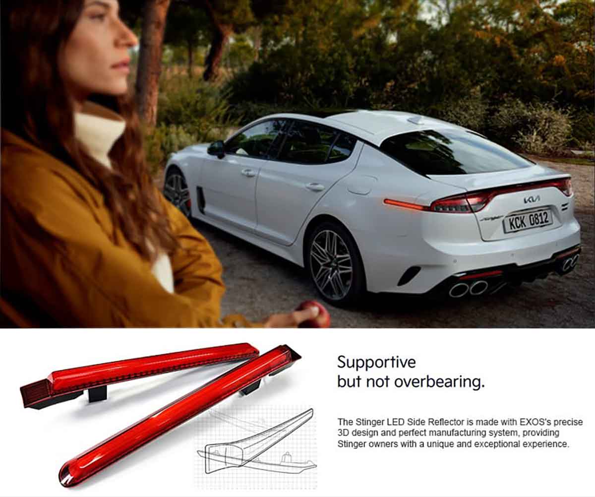

Designed and manufactured in South Korea by EXOS. All components, including the LEDs, are made in South Korea. The LED side reflectors have three functions:

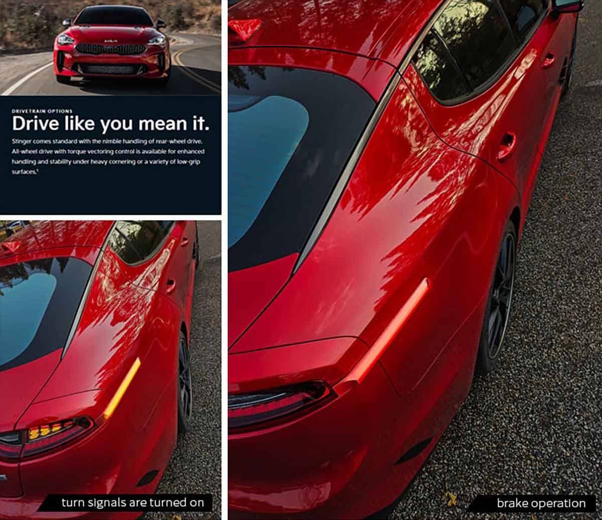

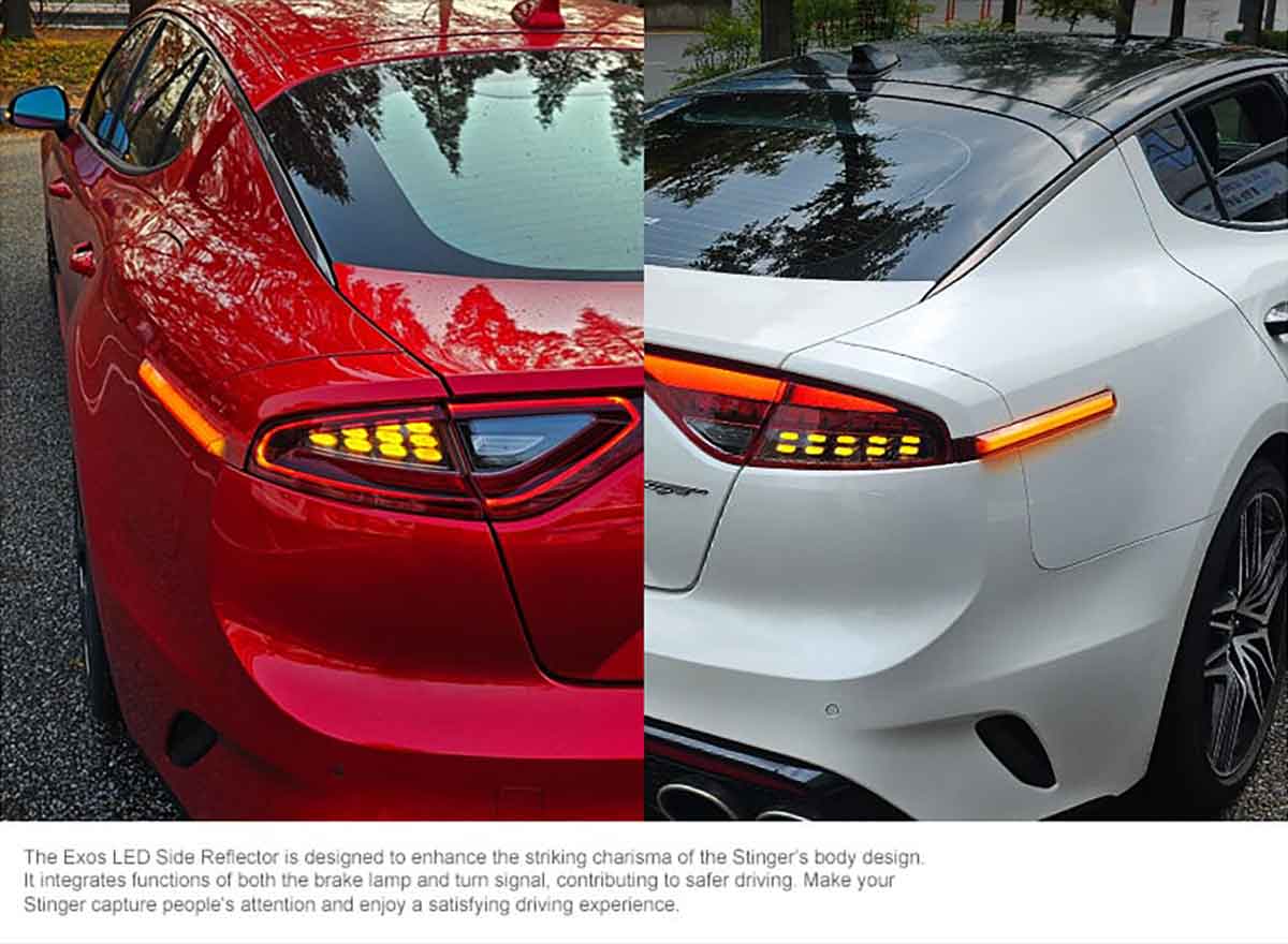

  • Light up red for as parking lights
  • Light up a brighter red for brake lights
  • Blink yellow for turn signals
