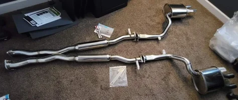

Installed a Megan Racing Catback a couple weeks ago. This exhaust isn't all that common and not very well documented in Stingers yet since it's only a year or so old, but from the tiny bit of info I was able to find on it, and from reviews for the systems they make for other cars, I decided to go with this one. It was between this and the MBRP. I do like the tone of the Megan Racing better. The MBRP might be a little louder, but I was looking for something on the less aggressive said for my daily.
I also found a very nice deal on it. KDM Project has it for $625. It was right about $700 after shipping. 304 stainless. Also comes with new gaskets, stainless steel bolts, and stainless brace on the back half.

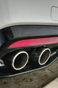

These particular tips are just temporary to eliminate the drone while I wait for my oval tips from Ali. These tips honestly don't look bad though imo. The sound is just what I was looking for, louder and deeper than stock, but nothing crazy.

*the photo below from underneath is from the Megan Racing website for the exhaust. I forgot to take one myself lol

It sounds like you're referring to the resonators I believe? Mine has those yes. If you look at the attached pictures on the original post you will see them on the first section. BTW are you installing the Megan exhaust or a different brand exhaust? It shouldn't matter, but just wondering.

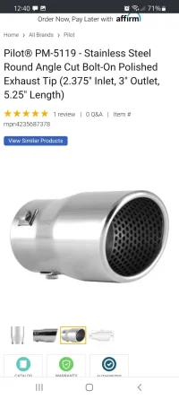

This is what I'm running now that can be seen in the photos. Be careful if you get these though, their QC seems bad because I bought all of these with the same exact part number, and two of them fit perfectly, one was slightly oversized but no big deal, and one was a decent amount oversized and was a big pain in the a** to get to clamp.

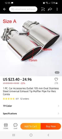

This is what I'm waiting for from AliExpress.

Got a part number for those oval tips?
nvm, found them.

Idk what exhaust you're running, but for this exhaust the 63mm inlet is perfect fit. Any smaller wouldn't work. Any bigger and would be a little hard to clamp.
