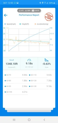

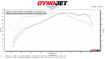

New Kia Stinger dyno and 60-130mph result from one of our Korean customers. Running JB4+EWG, WMI, intercooler, exhaust, pump gas+a can of octane booster. Factory turbos!
We usually don't share customer results (this isn't the first 500whp JB4 Stinger dyno I've seen) but what made this one unique was he also did 60-130mph times, matching the current record held by another Korean JB4 customer, so thought it was a very interesting data point.

I'm not really familiar with what is a good/bad 60-130 time.
What cars out there run similar 60-130 times?
See this is how its done you post a dyno along with some real metrics. @StungBlueGT2 tell your boy to do something like this. It will be helpful to see how it compares.
This time places him (tied for) 3rd on the Dragy leaderboard among stingers; the top two both have upgraded turbos...
Low 9 second 60-130 is moving out with a purpose. Most cars doing that stock tend to have AMG or RS or M in the name somewhere.

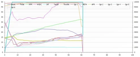

Curious.... Why the dip in power at 6k?
According to the log i'm not seeing any ignition changes at that RPM, nor am I seeing boost inconsistencies (boost is falling by that RPM, but that doesn't explain why the power jumped back up). Does this have something to do with the EWG function?
Not sure yet, we expected power to continue to dip towards redline but shot back up towards the end. Probably operating at the limits of exhaust back pressure and EWG holding capacity currently.

Just ran a 8.90 60-130. I was doing Jb4 stack on Tork tune, +.6 PSI and IAT spoof up to 90 in 40 degree weather. 22.7 PSI peak.
But if this RWD 9.18 is 500hp, how much is my 4100lb GT2AWD? Should find out soon!
