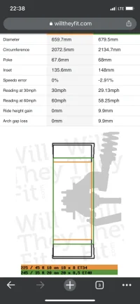

Hey everyone. I just got my 2022 stinger gt line awd and I'm new to the "mod/replacement" scene and am looking to change my stock 18 wheels to 20s. I am concerned about fitment/rubbing. I figured I'd post here and ask if these would work okay on my car. The car is stock, hasn't been lowered etc.
Looking to add these wheels.
Enkei TSR-X 20x8.5 +40
529-285-1240BK​
(can't post the link because I'm a new member)
And as far as tires, I was thinking 245/35/20.
Any insight would be super helpful.
Thank you!
Use this:
willtheyfit.com
I would try and get under the car to get measurements from the stock setup to the suspension components and lip of the fenders/quarters. This will give you an idea on what you’ll need in terms of offset and overall wheel widths.
I think you’ll need something closer to a 30 offset or less to push the wheels outboard and away from the suspension.
