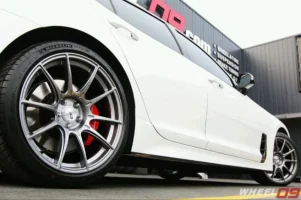

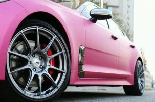

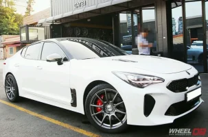

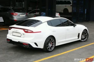

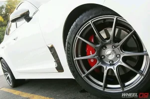

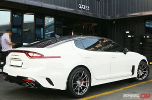

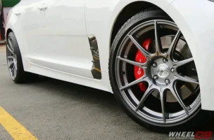

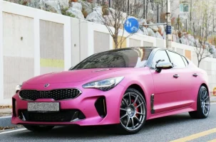

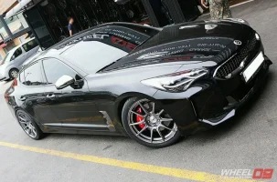

    Most people here use 245 40 19 in the front and 275 35 19 in the rear on aftermarket wheels. Most aftermarket wheels will be of size 8.5 and 9.5 and here are some pics of the same wheel with stock tyre and the wider tyre mentionned above.
    It is obvious that the thicker sidewall fills the wheel house better.
    stock tyre
    wide tyre (the black car is lowered I think)
    (wheel spec: 19x8.5+38 19x9.5+38)
