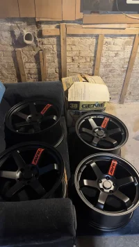

SlowiaGT2 New Member Joined Oct 5, 2021 Messages 1 Reaction score 0 Points 1 May 30, 2023 #1 I just bought Avid Av06 18x9.5 +32offset. My stock setup is squared. Are these wheels gonna fit just fine? What's the stock offset on the GT2 2018? Attachments IMG_0615.webp 164.1 KB · Views: 18
Snicklefritz Sustaining Member + Joined Nov 28, 2022 Messages 2,868 Reaction score 1,310 Points 118 May 30, 2023 #2 square offset on all model years is 34. Ima questioning if 9.5 will fit in front. will be fine in the rear. don't go wildly wide on the tires and you'll probably make those wheels work.
