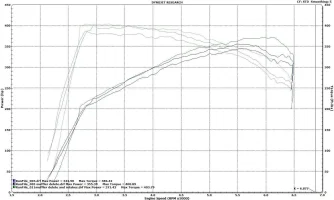

I am currently running jb4 map 5, e30, and intakes. What else is out there to make more power with a little bit of cost / return in mind? I was running 12.4 consistent yesterday (hot day with headwind).
Downpipes just dont seem worth the 10hp to deal with the oil seepage thats being reported, and the full exhaust is just way too horrible sounding for a street car anyways. No real turbo upgrade options. meth doesnt seem to make any more power than e30... Do I have it all wrong or is this pretty much it for the car unless I want to spend 5k on a motec computer?
You already have more airflow going in from intakes & extra boost, but without a free flowing exhaust your likely killing your top end HP. Torks dyno shows 50whp+ at 6100rpm with both intakes and muffler deletes.
808E0258-24F8-4909-B5DB-A7B92DA79822.jpeg By removing both of the biggest restrictions(intake box & mufflers) you should increase your top end significantly. Right now you probably have substantial back pressure running OEM exhaust, but increased airflow from extra boost & open air intakes.
I suggest trying muffler deletes for only $200 first, and maybe some sticky tires(if RWD) to lessen wheel-spin. Then if that isn’t enough to hit 11s I’d go with the Ultimate Performance DP combo which is good for about another 30whp and has HFCs so you’re not running into the catless issues & noise. BE0641FE-10A9-4889-A85A-66F635522F15.jpeg
Hope that helps and those upgrades should make a noticeable difference without breaking the bank.:thumbup:
View attachment 36617 By removing both of the biggest restrictions(intake box & mufflers) you should increase your top end significantly. Right now you probably have substantial back pressure running OEM exhaust, but increased airflow from extra boost & open air intakes.
I suggest trying muffler deletes for only $200 first, and maybe some sticky tires(if RWD) to lessen wheel-spin. Then if that isn’t enough to hit 11s I’d go with the Ultimate Performance DP combo which is good for about another 30whp and has HFCs so you’re not running into the catless issues & noise. View attachment 36618
thanks thats a big help. Does anyone sell a muffler delete pipe that isnt $500? I know it would be cheap to have made at a shop but its a hard time for me to have the car dropped off right now, id much rather just order one and do it one night at the house
