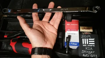

    Planning on doing my 2nd Earl Change today at 5,000 miles (1st was done with conventional oil at 500 miles) and will be using synthetic now that my engine is fully all broken in. Got all these new "Stinger Specific" Earl Changin' Tools for only the KIA, because it's special.
    Hard to see in the picture, but we've got a brand new 3/8" 27mm STEELMAN socket for the oil-filter-canister-housing.
    A Sunex 1/4" 10mm socket for the Milwaukee FUEL ratchet on a little extension for the under-panels,
    And a 14.5" extra-long wrench for the drain bolt at 17mm...
