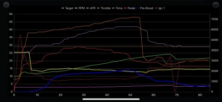

What’s the highest map you can go to with 93 octane?
Been using map 2. jb4, k&n cold air intakes, borla cat back, hks 45 spark plugs, eibach lowering springs. Haven’t done any logs but sounds good and drives really good. Just needs sway bars and stiffer suspension. J beat a early 2010 mustang gt and a Audi A3 sport, dusted lmao
Map 3 if you have fuel wires. If you don't they you will get misfires in 3rd gear into 4th. Fuel wires solved my issue and I had no problems on 93 running map 3. I used a bit of Boostane in a couple tanks and that was fun. Butt dyno felt the ever-so-slight increase in power.
ok cool thank you. Gonna stay at map 2. Might try 3 and 4, log immediately and check
