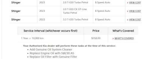

Dirty oil or gunk clogs up the vvt actuators on lots of cars. Put an oil system cleaner through which Kia does here each service.. GM its a known problem but I would put money on a stretched timing chain as the main problem but you could replace the crank angle sensor first as a cheap fix before going down the more expensive path.
