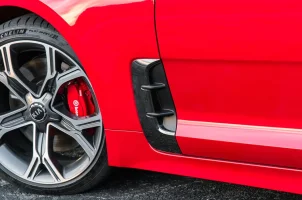

  15. NS_Stinger
    NS_Stinger Canada Stinger Enthusiast
    711
    185
    I'm guessing the functional vents behind the front wheels are a big contributor to this issue.
    • Disagree Disagree x 1

  17. NS_Stinger
    711
    185
    Oh i don't know maybe because dirt and water gets kicked from the front tires directly into that vent which just happens to exit directly in front of the panel gap that leads into the doors.
    I DD my car at the moment in the winter and can tell you a ton of salt and road filth gets thrown through those vents.

  19. NS_Stinger
    711
    185
    So to be clear, this exit from the front tire area which gets water and road debris kicked directly into it from the front tires and leads directly into the front door panel gap plays no part in the dirt and debris in the door panels? Can't say I agree at all with you on that.
