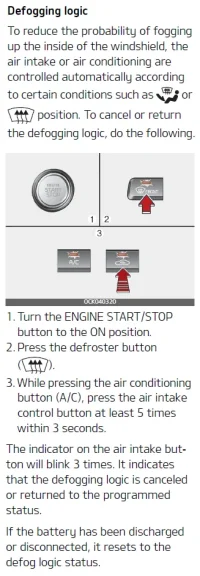

Oh cool, I just figured the defog button covered that function so the car wouldn't nanny me. I had no idea there was a cheat code to disable the defog logic.

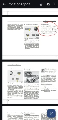

I swear some day I'll take a week off and read the Stinger bible/manual front to back. Hopefully in a hammock by the lake.
This seems to kinda work. Now when I cycle through the vents the AC light comes on when I toggle to the windshield mode. Now I can manually turn the AC off every time, but I wish it just left it off after the first time, that's kinda the whole point.
At least now I know when the AC is running.
And when it says "press the air intake control button" it's the "interior circulation button" as pictured, not that anyone would screw it or anything...
