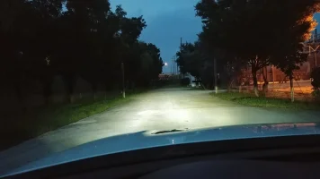

    Another update. I was able to index the passenger side bulb by trimming the locking tabs. It turns out that the factory 9005 bulb has a small tab at 12:00 and larger tabs at 4 and 8 o'clock, while these LED bulbs the small tab is at 4 or 8 o'clock. I was able to seat them originally, but they were not oriented correctly. With some careful trimming, I was able to get the bulb to mount upright, aiming the LED modules horizontally install of at an angle.
    Very nice improvement, even just having one side done. The pattern changed from a hotspot on the ground originally, and is now a nice fan of light on the ground with a sharp, horizontal cutoff at distance. This makes sense, considering the original installation had one LED module pointing at the ground at an angle, while the other was aiming up into the cutoff shutter.

    Got everything buttoned up, results shown below on the car and on the road. I'm pleased. I have about 4-5 hours of on-time so far, and no observed problems: still no error messages, and no failures to light up.
    One last thing I discovered is that I could use my phone and the stock bulb as a makeshift template for trimming the new bulb by:
    1. taking a picture of the stock bulb from directly in front of it
    2. zooming the picture to make it life-size
    3. holding the new bulb in front of the picture to compare the tabs to the stock bulb
    This made it easier to trim the tabs on the second bulb.
    That's all I have for now, unless I get some new inspiration or problem in the future. Let me know if any questions.
    Thanks all

    Looks good. Other forum members should find this useful.
