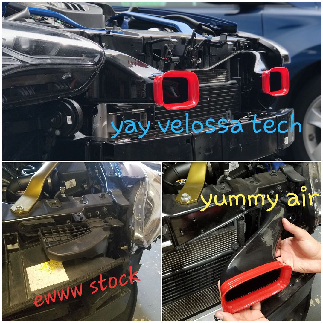

Do these really make a difference or is it more for the looks?

No proven dyno or track improvement from what I've seen.

In theory it will bring more fresh cold air to the air filter. The oem seems a bit restrictive where this is more free flowing and direct.
There are no proven dynos but I am believer that every little thing helps.
I personally have them and like them. I agree the price is a bit steep.

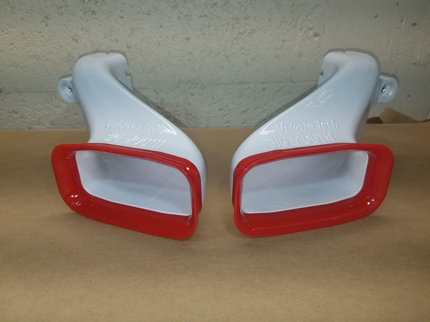

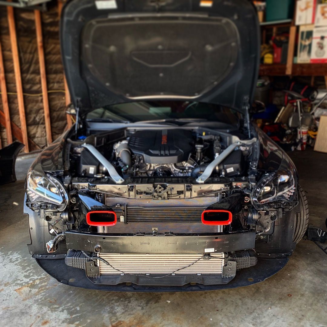

I did before and after testing and found the temps at the filter of my K&N intakes dropped quicker upon acceleration with these.
A dyno can’t prove the effectiveness of these unless you have a dyno with a variable feed span that matches wheel speed.
VelossaTech
Authorized Vendor
56
52
As others have said a dyno is not the right tool to measure performance. Not even a fan is enough to recreate the frontal dynamic pressure that is seen when the car is going 60 mph. You'd need a wind tunnel for that and those cost millions. We've seen increases in throttle response, reduction in wastegate duty cycle and increase in air mass (about 0.3-0.4 lbm/min). For cars like these that have undersized turbos, the added compressor inlet pressure and reduced inlet temperature bring down the compressor work load (RPM) given a target boost pressure for a boost targeting tune. For a load targeting tune you'd see a drop in compressor speed and WGDC which increases compressor efficiency, :)
