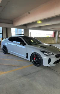

Plenty of people on the fb pages and here have run 235/40/19 & 265/35/19 and also 245/40/19 and 275/35/19 on the oem staggered 19” wheels.IMG_3606.webp
