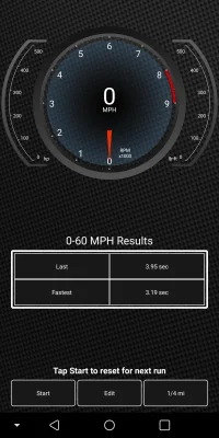

    Just got to do a few 0-60 runs. Best run 3.95 with just over a half tank and on the exact same road and fuel amount as my best run of 4.02 before the FMIC.
    Tork will update my tune to better take advantage of the fmic as well. I'll update after the tune.
    I called Ultimate and they said the unit i got was essentially pre production. Should fit better now but would be good to have the next installer confirm.
    Anyone looking for the Jonny Tig FMIC, mine's in the classifieds for $1200.
    Not totally sure of accuracy, this is obd connected app, but could be the first sub 4 second 0-60 for a Stinger?

  4. Kamauxx
    4,096
    1,538
    Get a Dragy. They're verified accurate.
