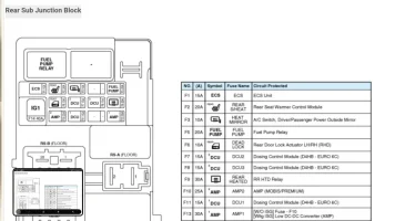

I’m wondering if anyone has a suggestion for the easiest wire to tap for ignition on/off power in the trunk area? I’d rather not run a fuse tap all the way back unless it’s necessary.
There's a green fuse in the rear that should work. Last I checked it's one of the 30''s. Otherwise the amp has an acc u can grab
Also the rear defogger fuse is switched
That's a good candidate
F9 in the rear fuse panel.
