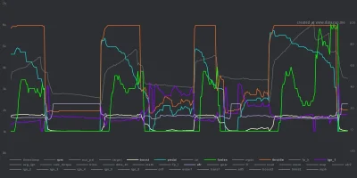

I am experiencing issues with my 2021 Stinger GT1 3.3L AWD. Occasionally, when I accelerate at highway speeds, I get a weak throttle response and the car will stutter and kick forward erratically. The first time this happened, the car went into limp mode and I had to pull over and turn off the engine. Now, whenever it happens, I just coast without accelerating too much and wait a few minutes before I regain power. I cannot reproduce the issue; it tends to occur when the car accelerates at a higher gear for too long, rather than downshifting. I have HKS gapped plugs, use 93 octane fuel, have BMS air intakes and a muffler delete, and recently installed a pedal tuner (the issue predates this). I am using Map 1.
Any help would be greatly appreciated!!
try turning off DWP, i had major issues with that previously and now my car will randomly lose boost under WOT or just CEL under WOT. Never been able to fix the issue but it started when i tried DWP for the first time.
