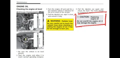

    I've checked agian this evening, the oil level is way above "F". I'm worried, I hope it did not damage the engine as indicated in the manual book.

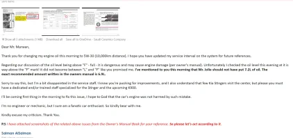

    I sent an email to the Service Manager and Cc'd the GM of Service Center. I'll be going to them first thing Tomorrow Morning.

    "May damage the engine" means, if you overfill routinely, over a period of time. There is no way that a single overfill, caught within a few hundred (or even thousand) miles is going to damage the engine (as long as you don't push the engine like a race car, anyway!). And even if you routinely overfilled the oil for the life of the car, it only "may" damage the engine (again, all or mostly conservative driving - between 2K and 4K RPMs - is good).

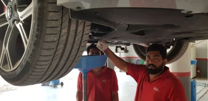

    I'm at service now. They're reducing the oil.

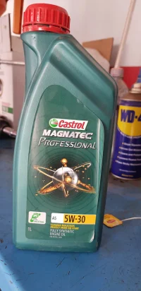

    This is the oil they use:
    • Like Like x 1

    Looks good to me! 5W-30 synthetic is precisely what the manual recommends.

    And boy, don’t they look happy about it!! Lol.
    Keep up them mate.
