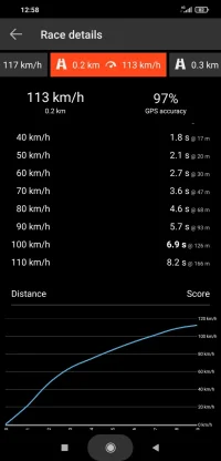

I have a 2019 CRDi diesel 2.2 litre GT Line S. Plugged a TDI tuner in, was simple and straightforward 2 minutes to plug in and 10 minutes to do all cable ties to secure it. First impressions I was unsure of how much of a difference it was making. It certainly doesn't feel like the 260bhp they claim but feels more like 220-240bhp , stock is 200.
I decided to try do a few pulls out of a layby onto a 70mph road. It's slightly uphill. Did launch control 3 times on sport mode , stock and got 7.9, 7.7 and 8.2. Switched it into map 7 (max) and managed a 6.9 first go. I need to record more pulls to really quantify. Location was not ideal, as I had to pull out from layby onto the main road and road surface changes and it's not an exact straight line but almost straight. @Hilleagle

@mtuckeruk that sounds very interesting.
Will be interested to know how much difference you feel it makes in every day driving and in the fuel economy!
Although if you keep giving it the beans, it will be returning 20 mpg!
How much was it?

I'm doing a few long drives in the next week will try remember to put it in map 1 and see how it goes. Whilst I was testing 0-60 I still averaged 35mpg (was surprised) but I was looping back each time so mpg wasn't so bad.
I find the Stinger's gearbox already so smooth and getting up to speed smooth so can be difficult to tell the difference but it's definitely there.
£345 all in with delivery using the web discount code.
I think it's either off, map 1 or map 7 the rest of the maps seem pointless

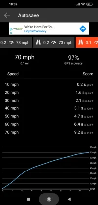

0-60 mph looks better than 0-100 kmph
Puts it pretty close to the stock 2.0 litre times
