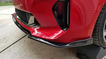

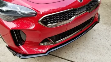

    See if you can get your money back and get the M&S splitter (make sure it is the advanced version). Solid and well made. I taped and bolted it on the front (8 bolts). Also used 3M adhesive promoter with the tape. The adhesive promoter makes the tape stick like the OEM KIA badge emblems, and we all know how hard those are to remove. No issues with my splitter and it is rock solid. Plus I have scraped the front a few times because my Stinger is lowered, but when I do scrape, it scrapes underneath the splitter and shows no damage from the front.
