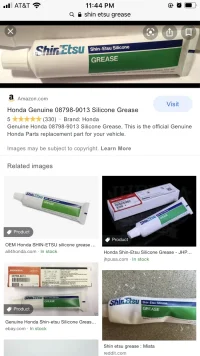

Door seals have dried out a bit. Not a big deal...mine did the same thing. Order some of this stuff and rub it in to your door seals. I just did mine 3 days ago when the seals started to creak a bit. Makes them soft and supple. I do it twice a year..once in the spring and once in the fall and the car is silent. If I don’t, the car creaks like a rocking chair lol. Easy and cheap fix and use sparingly as a little goes a loooooong
Thank you I just ordered this, will be here tomorrow! My driver side window started whistling above 35mph for no reason about a month and a half ago, been driving me nuts. I've got an appointment with KIA but they can't get me in until AUGUST due to recall repairs; hope this works:oops:
It worked thank you
