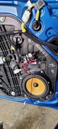

I bought JL Audio C1-650 components for the fronts and Kicker 46CS674 two-way for the rears. Sound is significantly improved even with stock head unit. Much better mid-bass. Less muddy.
  • Metra 72-7302 wire harness works perfectly with stock woofer wire. No splicing needed.

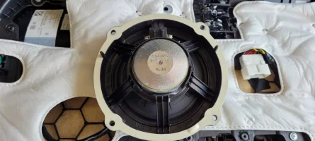

  • American International HKSB110 speaker brackets also work with the Stinger.
  • Stock front and rear woofers are identical and are labeled 4 ohm 20/40W.

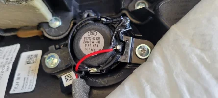

  • Stock front tweeter is labeled 3 ohm 20/40W.

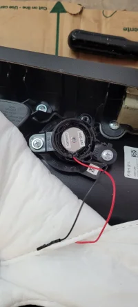

  • Stock front tweeter has an in-line high pass filter.

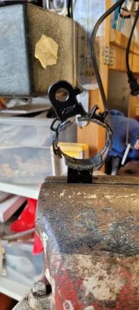

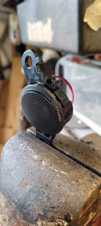

  • Front tweeter bracket hole is approximately 1.5 inch in diameter. I was able to dremel out the plastic to mount the JL Audio tweeter. If you have a tweeter that is 1.5 inch or smaller, you should be able to do the same.
  • There is a convenient brace on the inner door panel next to the woofer to attach a crossover.
