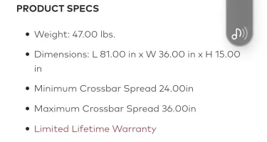

I have a cargo box but I haven't fit it yet. I don't believe the clearance will allow for anything below. There is about an inch.
I'll have the kayak mounts coming so I can check both.

With the kayak mounts at the edges, the moonroof opens.
The moonroof will not open with the cargo box.

This was very helpful... thank you very much! In your 2nd pic with the cargo box I can see the moonroof open, I reckon you stopped it manually before it hit the cargo box locks?
Thanks again... it looks amazing!
Yeah, it was open maybe three inches: very little space

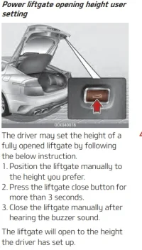

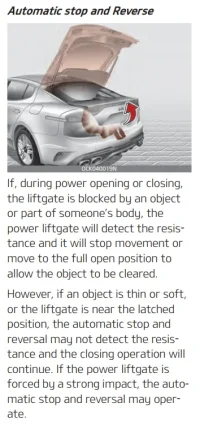

What do you do about the auto lift hatch when you've got the kayak loaded? I have a roof rack on order but I just realized that unlike my old car with a manual lift hatch where you can open it just a foot to grab stuff, the stinger is going to try to open electronically and hit the kayak.
From the 2022 manual:
