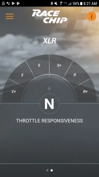

    After adding the XLR to the app: Screenshot_20180427-082139.png
    I have currently only tried the sport(S), sport+(S+) and race(R) modes while in comfort mode. These settings gave me the results I was looking for by changing the throttle response while in the comfort mode setting and allowing me to keep it there after restarting the car. The sport mode on the XLR was on par with throttle response of the built-in sports mode; however, turning it to race mode felt as though it eliminated turbo lag entirely and made the car more aggressive. I plan on trying more settings soon when my work schedule permits.
