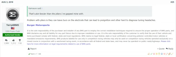

    I just saw this post from @Terry@BMS when I was researching spark plugs.
    Son of a gun, this might be my problem. I used a gapper similar to the one Terry sells. However, looking closer at the picture for Terry's version, I see that it's rounded where it touches the electrode. The one I used isn't and I noticed it put a small cut into the top of at least one electrode. I noted it, and put the worst looking spark plug in cylinder 4 since it's the easiest to get out. Surprise surprise, cylinder 4 generally has the worst timing. I totally forgot about this until recently, when I saw that cyl 4 was one of the issues.
    I also found out that I may have gotten knock-off Denso's from the company I ordered them from. I reached out to Denso yesterday to confirm whether or not they completely redesigned their plugs because the ones I got look nothing like the picture Denso has on their site. Mine don't have the blue rings and the post is dark grey, not brass colored. The text also looks slightly different.
    I think the next steps for me are to buy new Densos direct from Denso, buy Terry's gapper, and replace my plugs. Hopefully that makes a considerable difference in the tightness of my timing. And who knows, maybe I'll start seeing performance that more closely matches other tuned Stingers.
