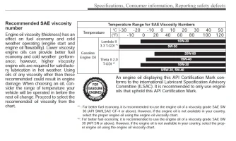

    I will stick with the oil Kia says to use on my 2.0 which is the appropriate viscosity
    ACEA C2 (or ABOVE). The 3.3 engine: API SM/ILSAC GF-4 above / SW-30 above. I will change oil every 5000 miles even though its on a 4 year lease.
  7. StingEm
    StingEm United States Active Member
    133
    30
    Someone at Kia was hitting the bottle a little early when they put the ACEA C2 spec in the manual for the 2.0. Those oils are used for their diesel engines. The Kia/Hyundai 2.0 Theta-II Turbo engine has always been recommended to use an ACEA A5 oil. Any modern full synthetic will meet the requirements.
    A fully synthetic API SN-Plus / Dexos 1 Gen2 oil will give it the best chance at a long and happy life, but if I was only planning on having the car for four years I probably wouldn’t care about any of this. I care because I’ll probably put over 150k on the car unless someone manages to total it for me along the way.

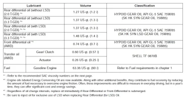

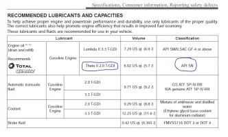

    Funny. I just checked the newest owner's manual available on KiaTechInfo for the 2018 Stinger and now it recommends API SN or above (see the attached image). I don't know why they printed the manual originally with ACEA C2, but they've now fixed it. Probably the same reason they forgot to recommend 91 octane in the original manual...
    As I said in earlier posts, I believe the best oil for this GDI engine will be the highest weight & smallest span (10W-30 for example if your temps are above 0F) with API SN-Plus or Dexos 1 Gen II ratings. The highest quality base stock synthetic is preferred. I'm not going to go crazy with the ultra-expensive oils though, so for my purposes Quaker State Ultimate Durability will do the trick at $20 per 5 quart jug. I'm not super happy that Quaker State didn't publish the NOACK on the most recent datasheets, but I don't see any reason it would have changed appreciably either.
  14. StingEm

  15. Kickin Kiaster
    Kickin Kiaster United States Newish Member
    13
    Location:
    New Hampshire
    Thanks StingEm for posting the most up to date and now apparently corrected, recommended oil spec for the 2.0T.
    Now I think all the online motor oil selector apps are completely confused about what to recommend!
